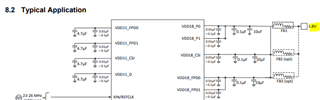

  • Hello Carlos,
    The TI network blocks access to file sharing sites, such as Google Drive, so I am unable to access your diagram. If you'd like, you can post a PDF or other attachment type in the forum instead.
    But anyway, yes, it is possible for separate 954 chips to be connected to the same power supply rails. You just need to make sure that each of the power supply pins on the 954 devices have their own separate set of decoupling capacitors, Ferrite Beads, etc... as defined in Typical Application section in the 954 datasheet. Depending on the noise in your system, more decoupling capacitors may be added to ensure 1.8V(+/-5%) is always supplied to the appropriate power rails.
    For example, the 1.8V voltage rail can be connected to the Ferrite Bead on the first 954 chip and the Ferrite Bead on the second 954 chip. You do not need to create 2 separate 1.8V voltage rails for each 954 device. One thing to keep in mind in your intended design is the increased current draw from the 1.8V rail.
    Please make sure to review the DC Electrical Characteristics table in the 954 datasheet in order to make sure the regulator or buck converter used is able to provide the required current to each device's power supply pin.
    Same advice for the PoC voltage. A single power supply rail can supply the PoC voltage to two 954 chips, just make sure there is a separate set of decoupling capacitors and a separate PoC network used for each device. Also make sure noise requirements can be met and that current through the PoC network does not exceed the rated limit defined in the datasheet, if you are using our recommended PoC network.

  • Hello Carlos,
    1. Yes, you can use a single voltage regulator to provide a voltage rail that will power both 954 devices. You just need to make sure that the two 954 devices do not share decoupling capacitors and Ferrite Beads. Make sure each device has a separate set of decoupling capacitors and Ferrite Beads, as defined in the datasheet. Also make sure the regulator can support the current draw from two 954 devices. Some simulation or physical measurements may be required, in order to make sure voltage ripple does not exceed +/-5% of the target 1.8V or 1.1V required at each voltage rail pin.
    2. Yes, you can use a single 12V voltage rail to supply the PoC over the two different cable links. You just need to make sure that a separate set of PoC network circuits are used on each device. Don't share components. Also keep in mind the current limits. The recommended 4G PoC network in the datasheets state that less than 150mA current draw through the PoC network, in order to maintain the impedance characteristics at the channel's operating frequency.
