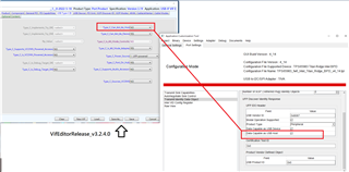

Our product is a Titan Ridge Bus-powered Device, so tested in PD In the "VIF" file, we set the option "Type_C_Can_Act_AS_Host" to "NO",
But the "Data Capable as USB Host" option of TPS65983B Application Customization tool is checked by default "YES".
The current problem is that the VIF "Type_C_Can_Act_AS_Host" is set to NO,  but the TPS65983B application customization tool is set to YES, so "TD.PD.VNDI3.E3" will fail during PD test.
Can the "Data Capable as USB Host" of the TPS65983B application customization tool be unchecked? Does it not affect the Device function?
