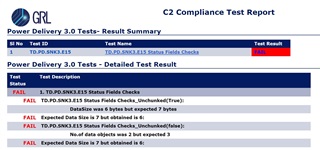

How can the following problems be solved?
When performing PD3.0 test, its TD.PD.SNK3.E15 test item Fail,
Does this part have anything to do with VIF?
TPS65983B Firmware Version : 6.67
Titan Ridge Bus-Power Device.
    From the failure description, it seems like there is a mismatch between the VIF and the project setting. Can you share the VIF used for testing?
    Regards.

    Thank you for the information. Can you also provide the project file? It might take a while for me to review this as I have other items on my hands.
  • Hi Tommy:
    Please see attached
    .Thunderbolt mini Dock-V6.67.pjt
    Thank you for providing the project file.
    Regards.
    Is it possible to provide the PD log for this specific failure?
    Regards.
