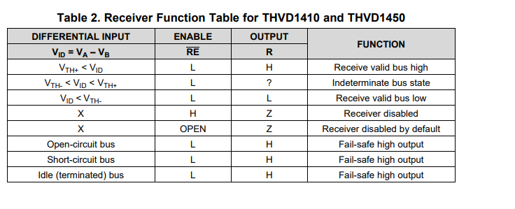

    The device, a s Clemens mentioned, doesn't really the modes that you are speaking of - have you verified the voltages according to the Rx table on the device in question:
    This is what determines the "R" pin state (received data stream). This is going to be a measure of A/B/ /RE and R at times of issue.

  • This device does not have any internal state; it should not be possible for it to lock up.
    The only explanation I have is that some voltage at the bus or power pins is out of range. Can you show oscilloscope traces of those pins in the field?

    That being said - if R is going high and is stuck that way - it could be the device responding to a "fail" condition (either open bus, shorted bus, or idle bus) and will output high (this isn't really a different state of the device - its internal thresholds count a voltage of -20mV or greater logic high preventing idle/short/open conditions from potentially oscillating)
    If this is happening in the field my question is what is different between lab and field tests - is it length or are there more changes?
    The next step to identifying the problem is to measure the A/B bus at the receivers in question. I'd imagine what you will see is after the system runs for a few minutes the voltage there is going to drop and it may be falsely reading a logic high at all times. This test will tell you/customer and myself if its an actual receiver problem or if there is some event in the system that causes attenuation - what that may be is variable but at this moment it could be 100% system level issue and nothing to do with the transceiver itself - I can't say that with 100% certainty if that's the case but understanding the voltage levels at the A/B pins of the receiver is the next best step to isolating the issue being seen.

    Thanks for the detailed analysis. I think you have touched up on the point mentioned by Clemens as well viz; "This device does not have any internal state" which is mentioned in the datasheet page number 19 Section 9.3 paragraph 2.
    I also agree that the device may be in one of these state mentioned by datasheet. This leaves us two options as below,

    2) I am not trying to conclude that the receiver has an issue. But we are almost sure that the receiver is going to one of its fault state which is not a short circuit or open one(theoretically) except the idle condition. If we assume it is assuming idle state my main question is how to take the driver out of the idle fault condition programatically. A solution to this can be a very good work around to solve my current filed condition. Later the issue can be properly characterized for further analysis.

    I don't think its the length - 9600bps at 400m shouldn't be an issue under normal circumstances - and since the units having issues are length independent I doubt its an attenuation issue (which it shouldn't be based on operating specs)
    As mentioned earlier there isn't internal states - so the bus idle mode to the receiver is just a logic high voltage. There is nothing that will cause it switch to a low voltage unless the A/B voltage registers a low state. Understanding 1. if this is actually the problem and 2. what the signal at A/B look like for devices that are failing communication is critical for finding a solution. With the information that  I have right now I can really only assume that the design is ok (tested in lab - the slightly shorter length probably isn't having that large of an effect) so information from the field system would be important as I don't have a solution when I am not sure of the problem - I can speculate but that doesn't help as without more its really just me listing every possible outcome when scope shots will tell me more about the issue at hand and will give me enough information to dig deeper into the issue.
