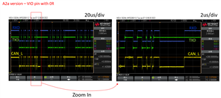

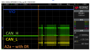

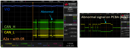

  • Hi Eric
    Sorry for late response. I have checked with my teammates.
    Here shows the snapshots with R73 = 0 ohm:
    The VIO is stable when CAN_H/L are correct signal, but sometimes can observe abnormal status(CAN_H/L) and VIO looks like with some interference.

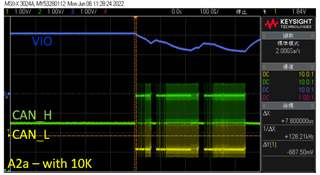

    And here shows the snapshot with R73 = 10k ohm:
    In this test case, we can observe that the VIO dropped when CAN transmit or receive data, but CAN signal are correct.

  • Hi Jasper,
    Thanks for sharing the extra info and scope shots.
    The "Abnormal signal" shown here is an error frame. This consists of at least 6 consecutive dominant bits and can be driven by multiple nodes simultaneously. For this reason, it's common to see a larger differential voltage during an error frame.
    The analog CAN signal in the third image looks good, so I don't expect the error to be occuring the CAN bus side of things. It seems likely to me that there is some misinterpretation happening on the CAN controller side. The fact that changing the Vio level corrects this makes me think it has to do with the digital TXD and RXD lines.
    I would recommend looking at the TXD and RXD signals on the driving node and capturing the signal states during the error frame at a similar timescale shown above (2us/div) This will let us see if there is any ringing or noise on the RXD line that may have caused an error to be detected.

  • Hi Eric
    Here shows the TXD/RXD signal:
    Do you have any idea about TXD and RXD have different signal in the snapshot which will cause the error frame?
    Thanks.
    Jasper
  • Hi Jasper,
    The TXD signal here is driven by the local CAN controller and causes the TCAN1044 to drive the CAN bus to a dominant state (CANL low). When we see TXD is high while the RXD signal and CAN bus are dominant, this means a different node is driving this bus state. In this case, a different node has recognized some problem with the TCAN1044's transmission and has driven an error frame on the bus.
