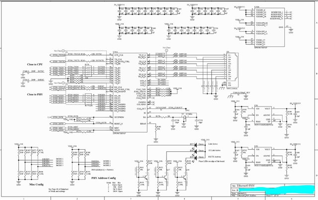

We have connected an ethernet phy DP83867IRPAP device to our custom silicon on our in-house developed board, and the bootstrap is set to configure the device in RGMII mode, Autoneg enabled. In RGMII mode 1G we could see the device responds properly, the link is set up, and with Autoneg enabled, we could see the phy configures itself into either 100Mpbs or 1Gbps based on the type of connected peer.
Unfortunately, we are unable to transmit/receive ICMP packets (ping) from our target to the host for 100/1000 speed.

The trace lengths between the MAC and PHY interface on PCB are as follows:
We could see that if we ping from target with the delay control registers (RGMIIDCTL) set to 0x0 i.e both RGMII_RX_DELAY_CTRL/RGMII_TX_DELAY_CTRL set to 0.25 ns
the connected PC reports RX ERROR in ifconfig.

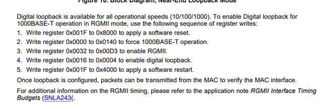

    The timing requirement doc specifies the following sequence for setting the Digital Loopback.
    What are the implications of the bootstrap pins, or other PHY registers when we are testing loopback mode?
    Do the default register values or any other settings apart from below mentioned registers interfere with loopback mode operation causing it to fail?
    From the document, it is unclear as to how to confirm whether loopback is passed/failed, could you please elaborate on how to achieve this?
    It would be good if you could shed light on the above queries as these are blocker and high priority.

  • Hi Sagar,
    Clock amplitude is expected to equal VDDIO, 1.8V in your case, for all speeds. This may be worth investigating.
    Ping requests are not the appropriate command to be testing in loopback mode. PRBS generator and checker should be used instead. Please conduct a reverse loopback test and use PRBS from the link partner side to push and check data, as well as the MII loopback test pushing PRBS data from the MAC side. As you noticed, these instructions are listed in section 2.8 of the troubleshooting guide. There are not any other register or strap values that would interfere with this test.
    Can you also provide scope shots of the RGMII signals (RX_CLK and RX_D0 at the PHY, as well as TX_CLK and TX_D0 at the MAC).
    Your schematic looks okay. Though, why are TX_D4-TX_D7 pins shorted to ground? They should be left floating if unused.

    5) The TXD4 to TXD7 are grounded as per the recommendation within the datasheet. Please let us know if we have misinterpreted the below recommendation wrongly.

    Additionally, based on our observations and the skews, we thought of setting the RGMII_TX_CLK_DELAY/RGMII_RX_CLK_DELAY to 0 i.e set TX/RX to be aligned with the clock, for which we wrote 0x00 over there, and to our surprise, we see that 100 Mbps works but 1Gbps fails in U-Boot.
    But what we couldn't understand is setting the RGMIICTL to 0x0 disables RGMII Enable Bit and the phy starts to operate in GMII mode as per following context into the datasheet, whereas on board the interface is RGMII.
    8.4.1 MAC Interfaces
    The DP83867 supports connection to an Ethernet MAC via the following interfaces: RGMII, GMII, and MII.
    The RGMII Disable strap (RX_D6) determines the default state of the MAC interface. The RGMII Disable strap
    corresponds to the RGMII Enable (bit 7) in the RGMIICTL register (address 0x0032). When RGMII mode is
    disabled, the DP83867 operates in GMII mode.
    Could you please shed some light here? How does it work in U-Boot even if phy is wrongly configured?

  • Hi Sagar,
    Why do you want to operate the device in GMII? Your schematic is not configured for GMII. Please keep bit[7] of the RGMIICTL register as 1 to continue using RGMII and tuning as you have been doing to meet the specs listed in section 7.9 of the datasheet.
    David
