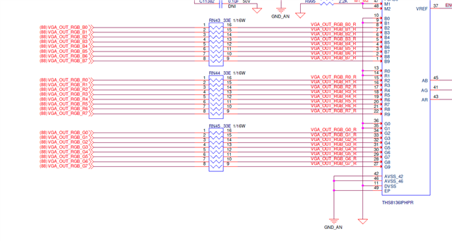

We have some Queries regarding selection and functional of THS8136IPHPR IC .
1) can we use this IC as VGA Output, with Horizontal and Vertical Sync directly from uP/ FPGA ? if Our understanding is correct and how to set the delay for data and HS/VS timing synchronization?
2) THS8136IPHPR provides  30 bit pixel RGB input data , Our requirement is 24 bit RGB. we have ground the Low bits of each RGB , is our understanding correct ? (Refer Image)
3) Out required output voltage level is (-0.3 V – 0.7 V) for VGA. As per datasheet we require 3.83K ohm register connection with FDADJ. As our application is 24 bit RGB input , assume the input at R of RGB input is 0011111111 ( as two LSB are connected with ground) . Will this Provide 0.7 V output for analog R?
