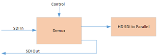

I have HD-SDI (1.25G) input video.
I want to use a demux.
option 1 is to do SDI to parallel and option 2 is to take the SDI out.
Is there any IC for this purpose?

Greetings,
Please note HD-SDI is 1.485G or 1.4835Gbps.
Please consider LMH0397. This part has SDI input and SDI output. ADditionally it has 100-ohm output that can be used by FPGA to provide HD-SDI to parallel interface.
