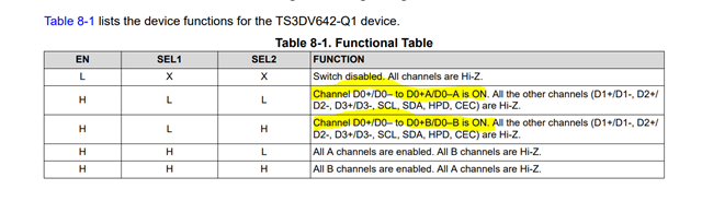

I see below table in datasheet. But I don't understand what these two function mean. why only two wire pass through? Thanks.

This is for one lane application so you want to turn off all unused lanes to minimize the crosstalk.
