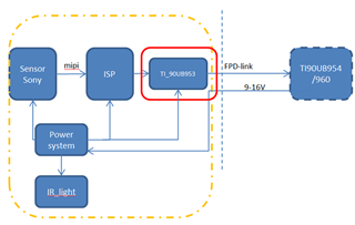

1.Could you you help confirm that the following design is OK? please refer to following block diagram ,THX
2.Does 953 receive ISP? Currently the Sensor interface has mipi & DVP.

Hello Kygo,
Thank you for the good news. Well done!
1) Yes, the design looks okay. Question, how will you be providing power from ECU to Camera? Is it over PoC or a seperate cable as shown?
2) Normally yes, but what is the resolution, data type and frame rate coming out of the ISP? and what is the Interface? is it also CSI ?

1)POC is not currently considered
2)Because of the need for deformation correction, a structure with DVP input is required ! So I will suggest DS90UB953TRHBRQ1 to RD for DVP input required !
Kygo,
The UB953 has only a CSI-2 interface, so you can't pair it with a DVP (parallel) ISP!!
