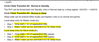

I had few observations regarding the additional steps required to put the DP83TG720R (1000 base T1) phy to sleep mode.
I see from the datasheet
Here we have two observation we are currently using the linux phytool commands to make to communicate with phy2
phytool write eth0/5/0xD 0x001F
phytool write eth0/5/0xE 0x018B
phytool write eth0/5/0xD 0x401F
phytool write eth0/5/0xE 0x00C0 or phytool write eth0/5/0xE 0x0080
We are using the the indirect writing of the address as mentioned in the datasheet

    Please see the following for directions on sleep entry and exiting sequence for DP83TG720:
    Sleep Entry Sequence
    Initial condition: DP83TG720 linked up to link partner
    Step 1 : Program PHY (local and remote) to “allow sleep entry”.
    Step 2 : Make “Wake” pin low for both local and remote PHY
    Step 3 : “Initiate sleep request” from the required 720 PHY device.
    Step 4 : INH will go low on both sides after step 3. Use INH to disconnect the supply of both the PHYs.
    Script to allow sleep entry
    000D 001F
    000E 018B
    000D 401F
    000E 0180
    Script to initiate sleep request
    000D 001F
    000E 055F
    000D 401F
    000E 4000
    000D 001F
    000E 0560
    000D 401F
    000E 0000
    000D 001F
    000E 042F
    000D 401F
    000E 0007
    000D 001F
    000E 041E
    000D 401F
    000E 0100

    You are setting the address 18b to 180 meaning that bit 7 and 8 is set to 1
    Next is the part i am little confused or i am looking into a wrong manual i am not sure
    000D 001F
    000E 055F
    000D 401F
    000E 4000
    Please correct me if i am wrong here we are trying to set the address 55f with a value 0x4000 assuming the above commands of 18b i mean the fromat of the commands but here in the user manual if i can see
    I cannot see the register 55f in the register maps can you please explain what this sequence of bytes are doing for the initiate sleep request please to have a good understanding
