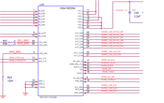

Questions from customers:
1. The SOC side determines that there is a DDC query resolution, and the CLK/DATA action can be seen on the HDMI connector side. But in the end, there is no signal from HDMI OUTPUT (when measuring Pin22 OUT_CLKP and seeing the mS level, a waveform similar to square wave LOW will appear, which seems to be a non-stop LOOP) Currently, there is no porting for PIN38, 39 SRC. Is it correct that there is no signal output?
2. In the final experiment, the SN65DP159RSBR is removed, and the HDMI signal can be output normally by jumping directly from the SOC end to the Connector end (just to rule out whether the HDMI interface of the SOC end works normally)
 Does SN65DP159RSBR need porting?
 Can you provide suggested porting values, porting guide?
