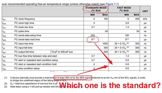

Part Number: PCA9545A
Hi Team,
Which the min value customer should look for about he tsdh spec? In our D/S, we recommend two values(one is 0ns, another one is 300ns). Thanks.

Hi Team,
Any response here? Thanks,
Stanley,
This comes from I2C standard, our I2C device isn't affected by this timing spec. The latest version of the spec still calls for 0 without a call out on a 300ns on SDA. It only requires that SCL falls below 30% of VCC before SDA enters the 30-70 or 70-30 range.
