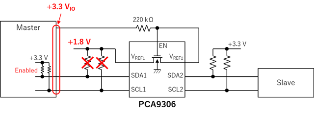

I'd like to ask if a connection described below is allowed for PCA9306 or not.

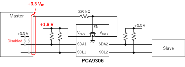

A PCA9306 device is used as an I2C bus switch. Pull-up resistors on the side 1 and the VREF1 pin are mistakenly tied to +1.8 V while the I/O level of the master device is +3.3 V. If the external pull-up resistors are removed and the master device's internal pull-up resistors are enabled to fix this issue, can the PCA9306 work properly? In this configuration, the VREF1 pin voltage stays on +1.8 V while the I2C bus signals go up to +3.3 V.
Original Circuit
Plan to Fix The Issue
