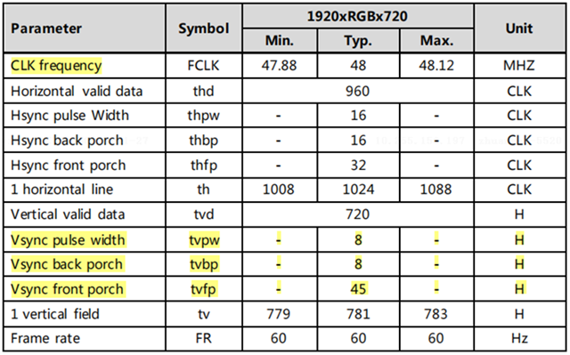

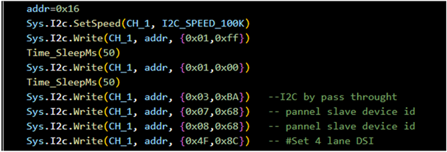

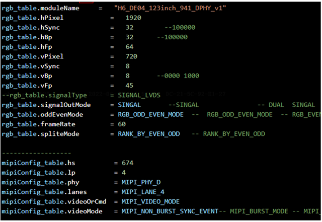

1, DS90ub941as-q1
2, Timming
3, Screen Spec
Tks & BRs

  • Hi Marsh,
    This might have to do with the DSI packet / settings on 941 if 947 is outputting properly.
    Do you have access to a DSI packet analyzer? If not, do you probing access to GPIO pins? We have a debug mode that can map the VS/HS signals to GPIOs to check to make sure there isn't any glitches in timing parameters, etc.
