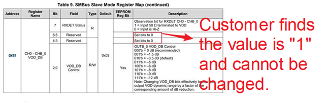

Customer find the 0x11 register reserved bit value is not aligned w/ our datasheet and can not be re-written, pls see below figure. Is that okay to keep 6/5 bit as "1" here? Thanks.

Hi Stanley,
I would not expect this to cause issues.
