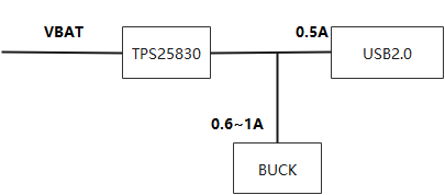

Customer use TPS25830A to supply a 0.5A USB slave. At the same time, they want to also use TPS25830A 5V output to supply an on board load which is lower than 1A.
Is it OK to do that?

It's fine.
For SDP 0.5A, it's for portable device such as phone instead of inactive load.
If you have any other concern, contact me any time.
