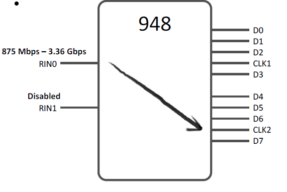

If we want to RIN0 input and output D4-D7 at the usage of UB948, like below figure, is it ok? How to configure it? Thanks!

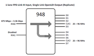

You could configure the 948 to work in 1-lane FPD-Link III Input, Single Link OpenLDI Output (Replicate) - See Image below.
This configuration allows you to use RIN0 lane as the main FPD-Link III input, and duplicates the LVDS signal on D4 to D7 outputs.
This could be configured through the Mode_Sel0 (Setting#[3] or Setting#[7]) - See PDF below.
