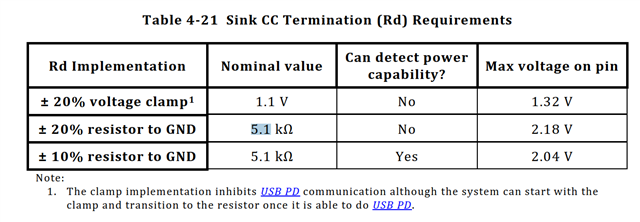

Dear expert,
When TPS25830A connect with a type A slave, CC1, 2 pin can left open, right?
