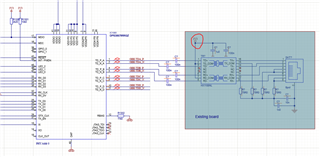

on a custom board we plan to to use the DP83867. Unfortunately, the magnetics are located on another, existing board that can't be changed. That board was designed for a PHY with current mode line drivers and the center taps of the magnetics are pulled to 3.3V. My concern is now that this does not work in combination with the voltage mode line drivers of the DP83867.
 Is it possible to decouple the line drivers from the 3.3V bias voltage using capacitors? The complete circuit would then look like this:
My second question: Are there GBE PHYs with current mode line drivers?
