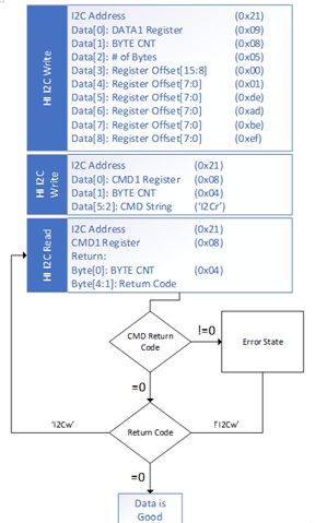

[Q1]
About page.1.
I understand that "r" is correct (R is incorrect).
Is my understanding correct?
<Excerpt from the material>
For example, the I2CR command you would write the following group of characters to the CMD1 register {4, ‘I’, ‘2’, ‘C’,’R’}
[Q2]
About “Here is an example of how to use the I2Cw command:”.
I understand that "I2Cw" is correct (I2Cr is incorrect).
I'm worried if it's set to "I2Cw".
[Q3]
I can’t find Slave address in the command and flowchart.
Could you please let us know the meaning of this command example?
[Q4]
About Data[1] BYTE CNT (0x08).
Is "8” correct?
Because, I understand that Data[3] to [8] are 7byte so not 8byte.
[Q5]
Could you please let us know the meaning of “Data[2]of Bytes”?
[Q6]
About Register Offset of Data[3] to [8].
I guess that Does not match the description of “3.4.2 'I2Cr' - I2C read transaction of TPS25750 Host Interface Technical Reference Manual”.
Could you please let us know the reason?
I'm sorry for the many questions and if my understanding is wrong.
I’d greatly appreciate your verification.

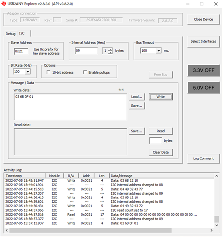

  • Hi Chuck-san,
    I have aditional quesetion.
    I understand that the I2Cr setting is later in the document.
    >Here is the I2C traffic view of a Register Read from the TPS25750.
    I would like to know a concrete example of "I2Cr" using " USB2ANY ".
    However, I don't understand what to change.
    > bust the Data (register (0x08) and CMD register (0x09) writes need to be changed to match the TRM document referred to above
    I apologize that my comprehension is lacking..
    I guess that "I2Cr" can be executed with the following settings.
    Could you please let us know if you have any advice?
    1) Load the DATA1 register
    PD address | DATA1 register | #byte count | BQ address | BQ register | BQ #read bytes eg:
    0x21       | 0x09          | 0x03       | 0x6B       | 0x12       | 0x10
    2) Load the CMD1 register with "I2Cr"
    PD address | CMD1 register | #byte count | 'I' | '2' | 'C' | 'r'
    0x21       | 0x08          | 0x04       | 0x49 | 0x32 | 0x43 | 0x72
    3) OUTPUT DATA
    Read DATA1 register
    Hide

  • Hi Chouse-san,
    Our customer use USB-PD-CHG-EVM-01 and USB2ANY.
    However, they can’t read suitable register value.
    Even if they use USB-PD-CHG-EVM-01,
    is it possible to execute pass-through mode using USB2ANY?
    By the way, they tried to read to REG0F_Charger_Control_0 Register of BQ25792 on USB-PD-CHG-EVM-01 by USB2ANY.
    However, the read result is " 0x04 0x00 0x00 0x00 0x00 ".
    This value is incorrect because resister default value is 0x12.
    If USB2ANY can support pass-through mode, could you please let us know appropriate method?
    Step1
    0x21       | 0x09          | 0x03       | 0x6B       | 0x0F       | 0x01
    Step2
    Step3
    The read result is " 0x04 0x00 0x00 0x00 0x00 ".
    <BQ25792 datasheet>
