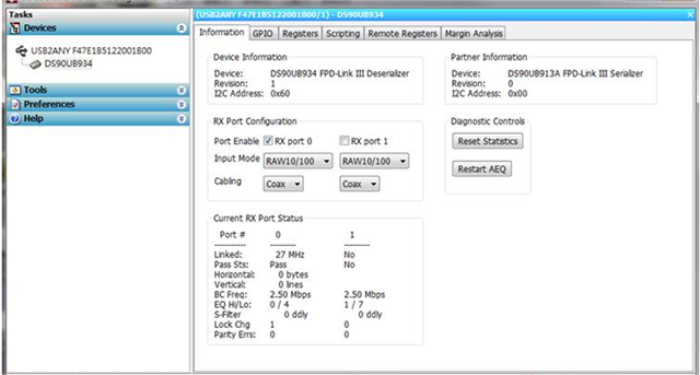

  • Hi Justin
    At present, we have connected with the DS90UB934 EVB. Judging from the light signal on the EVB, there is a Lock, but the I2C Address cannot be read. ( DS90UB934 EVB connect Leopard 933 camera )
    The measured PCLK is 54.59MHz (as shown in the figure below), and the Camera does not seem to operate normally.
    The following image is the information captured by the Analog LaunchPAD tool
  • Hello Kygo,
    1. Just to clarify, is the measured PCLK signal from the 933 in the Leopard Image Sensor?
      1. If there is no PCLK signal being sent into the 933 or the PCLK input does not meet the specifications for jitter, rise/fall times, etc... defined in section  Recommended Serializer Timing For PCLK in the 933 datasheet, then the internal clock in the 933 device is used to drive the channel connection. This connection is used to ensure I2C commands can be sent between the SER/DES devices, but video data will not be transferred if the internal clock is used. If the PCLK input into the 933 is valid, then the line rate will be driven by PCLK and video data transfer will be possible. In both scenarios, LOCK will be HIGH, but video data transfer will only be possible if PCLK input to the 933 is valid.
    2. If you are connecting a 934 EVM to the 933 in the Leopard Imager, then can you confirm that the MODE settings on the 934 EVM match the ones on the 933?
      1.  Also confirm the jumpers match the desired setup and that PoC is enabled. Also make sure the BISTEN pin on the 934 EVM is pulled LOW.
    3. Can you provide a register dump of the 934?
    4. Can you also read register 0x4D in the 934 EVM multiple times, and confirm that the LOCK_STS bit is always set to 1 and the LOCK_STS_CHG bit is constant at 0?
    5. Can you run the Margin Analysis tool as well and post the results?
    Justin Phan
