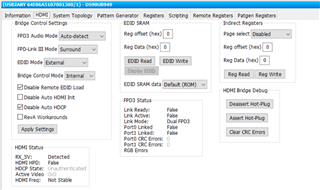

I connect this board with Mini USB , (set J33 to get power with USB , the LED on boad turn on ).
the S1, S2, S3, S6 are also with default setting.

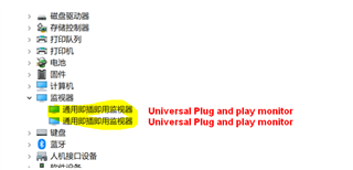

I check HDMI info in the device manager in my windows 10. my windows 10 can recognize the second monitor in the list.

Q3: the infomation on ALP is list below, Can you help to check if there other problem on my configration?
Infomation tab of ALP : ( althogh it is link with line and usb)
Current Link Status:
Link to Deserializer : No
Link to HDMI source : No

    [FA] - Your HDMI HPD signal is reading false because you don't have a deserializer connected to the DS90UB949. If want to force HDMI connection without having a Deserializer connected to the 949 you need to you would need to set register 0x5C bit[6] high - (board.WriteI2C(serAddr,0x5C,0x42)) to force link detection

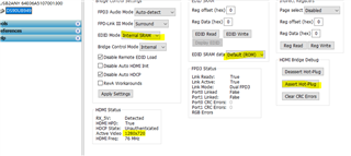

    thanks for your info.  It has some improvement but not work yet.
    [Board Setting]
    0) write the EDID with your method into board. (please refer to below write progress)
    1) Set register 0x5C bit[6] high.  (Force HDMI ouput without Deserializer );

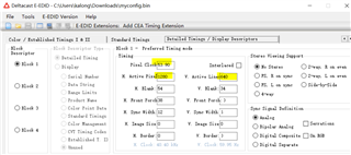

    2) Assert Hot-Plug in ALP HDMI tab. ( with this setting ,  My PC then can find the secondi monitor in device management list);
    3) Extend my desktop to second monitor in my PC ("Win" + "P", then select extend mode in PC )
    4)  Set output resolution in my display setting page on my PC.
    5) the MODE_0, MODE_1 and IDx settings on the board are set as default.

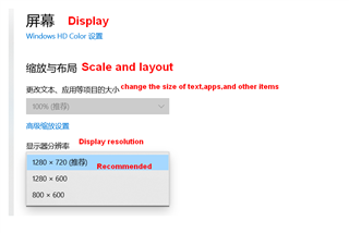

    b. you can see my EDID tool, the resolution is 1280x640, (640!!!)  , but my computer only list 3 options (1280x720, 1280x600, 800x600) ? What problem is here?  I write the EDID with script (128 bytes), but there is no 1280x640 in my computer resolution setting list. Is there any wrong in ALP HDMI tab ?
    Don't do this step, it shouldn't be needed if you are forcing 0x5C[6]. Is it required for successful detection of HDMI sink?
    1)  I change the Hot-Plug setting and 0x5C bit[6] , but when I turn off the usb and give 5V power with USB again, the setting disappear, and not saved.
    If no DES is attached, only use 0x5C[6]. Is the device resetting/repowered as well?
