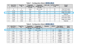

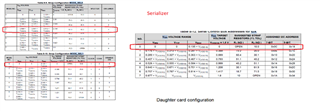

we areusing custom serialiser (ub941)daughter card and deserialiser to convert MIPI-DSI to LVDS.
the back light of the display is turning on.following are the configuration that we have used in serialiser and deseriliaser.
Serialiser:
Deserialiser:
FPD link : DUAL
single channel LVDS output
also attaching the register dump of serialiser and deserialsier.

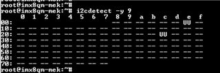

root@imx8qm-mek:~# i2cdump -f -y 9 0x0e
No size specified (using byte-data access)
0 1 2 3 4 5 6 7 8 9 a b c d e f 0123456789abcdef
00: 1c 00 00 9a 00 00 58 00 00 01 0b 00 67 30 00 00 ?..?..X..??.g0..
10: 00 00 00 8a 00 00 fe 9e 7f 7f 01 00 03 00 01 00 ...?..?????.?.?.
20: 0b 00 25 00 00 00 00 00 01 20 20 a0 00 00 a5 5a ?.%.....? ?..?Z
30: 00 09 00 05 0c 00 00 00 00 00 00 00 00 00 81 02 .?.??.........??
40: 10 94 00 00 00 00 00 00 00 00 00 00 00 00 00 8c ??.............?
50: 16 00 00 00 02 00 00 02 00 00 c9 03 07 06 44 94 ?...?..?..????D?
60: 22 02 00 00 10 00 00 00 00 00 00 00 00 00 20 00 "?..?......... .
70: 00 00 00 00 00 00 00 00 00 00 00 00 00 00 7f 00 ..............?.
80: 00 00 00 00 00 00 00 00 00 00 00 00 00 00 00 00 ................
90: 00 00 00 00 00 00 00 00 00 00 00 00 00 00 00 00 ................
a0: 00 00 00 00 00 00 00 00 00 00 00 00 00 00 00 00 ................
b0: 00 00 00 00 00 00 00 00 00 00 00 00 00 00 00 00 ................
c0: 00 00 82 00 38 00 00 64 40 00 00 00 00 02 ff 00 ..?.8..d@....?..
d0: 00 00 00 00 00 00 00 00 00 00 00 00 00 00 00 00 ................
e0: 00 00 82 00 28 08 00 00 00 00 00 00 00 02 00 00 ..?.(?.......?..
f0: 5f 55 42 39 34 31 00 00 00 00 00 00 00 00 00 00 _UB941..........
*****************Deserialiser*********************************
root@imx8qm-mek:~# i2cdump -f -y 9 0x2c
00: 58 04 00 f0 fe 1e 00 1c 00 00 00 00 00 00 00 00 X?.???.?........
10: 00 00 00 00 00 00 00 00 00 01 00 00 13 19 90 09 .........?..????
20: 90 00 40 30 08 00 83 84 11 00 00 00 00 00 00 00 ?.@0?.???.......
30: 00 00 90 25 01 00 00 aa 00 00 00 04 20 e0 23 00 ..?%?..?...? ?#.
40: 43 03 03 00 60 88 00 00 0f 02 00 08 00 00 63 00 C??.`?..??.?..c.
50: 03 10 00 01 80 00 00 00 00 3f 20 20 00 00 00 00 ??.??....? ....
60: 00 00 00 00 10 00 00 00 00 00 00 00 00 00 00 00 ....?...........
70: 00 00 00 07 07 08 00 00 00 00 00 00 02 00 00 00 ...???......?...
a0: 00 00 7d 00 00 00 00 00 00 00 00 00 00 00 00 00 ..}.............
c0: 00 00 00 00 00 00 00 00 c0 00 00 00 00 00 00 00 ........?.......
e0: 00 00 00 00 00 00 00 00 00 00 00 00 00 00 00 00 ................
f0: 5f 55 42 39 34 38 00 00 00 00 00 00 00 00 00 00 _UB948..........
root@imx8qm-mek:~#
