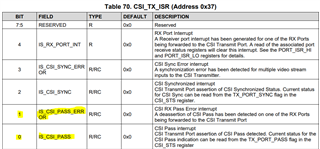

  1. For UB936 power up sequence, why need to hard reset like below figure?
  1. What is the meaning of 0x37 bit 0 and 1? If they are both set, what is the meaning?

  • Hello Jiawei,
    1. The Power-Up Sequence figure is meant to convey a lot of information. The "Hard Reset" is not required as part of the device power-up. If VDD_SEL=LOW, then you just need to make sure VDD18 and VDDIO are pulled to a stable HIGH before PDB, within the timing defined in the datasheet. If the customer would like to perform a "Hard Reset" on the 936 device, then they would need to wait at least T7 seconds after PDB has pulled HIGH and the PDB pin needs to be pulled LOW for at least T8 seconds to perform the "Hard Reset".
    2. Register 0x37 is the Interrupt Status register for the CSI-2 TX Port. If the Interrupt Service Routine is enabled in register 0x36, then the INTB or GPIO pins will send a signal to the processor to indicate that an interrupt condition has occurred. The corresponding bit in register 0x37 will be set as well and the user needs to read register 0x37 to clear the bit and clear the interrupt. See Section 7.5.8 Interrupt Support in the 936 datasheet for more details.
      1. Register 0x37[0] is an interrupt condition where the bit will be set HIGH if the TX_PORT_PASS bit status is changed from LOW->HIGH. TX_PORT_PASS is a status bit that indicates that valid data is available on the CSI-2 TX Port and that the CSI-2 TX Port is outputting video data.
      2. Register 0x37[1] is an interrupt condition where the bit will be set HIGH if the TX_PORT_PASS bit is changed from HIGH->LOW. This means an interrupt has occurred because the CSI-2 TX Port is no longer able to detect valid data to output and has stopped outputting video data.
      3. Both bits can only be set by enabling the interrupts in register 0x36. If both bits are set, then that means that the TX_PORT_PASS bit went from LOW->HIGH and HIGH->LOW before the user cleared the bits. Note that register 0x37[1:0] are cleared on read and will maintain their status until the user reads the register through an I2C write.

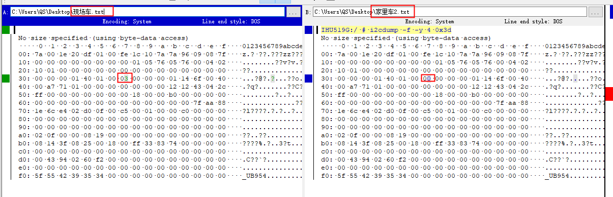

  • Hi Phan,
    Thanks for your reply. I met another black issue (won't recover until power off and power on) and at this moment lock is high and 0x73-76 are stable. Below is the registers dump of abnormal (left) and noraml (right).
    • About 0x37 bit0, bit1, you said 'Both bits can only be set by enabling the interrupts in register 0x36'. But from the register dump, we can see 0x37 bit0, bit1 both set while 0x36 is 0x00, could you kindly tell me the reason? And at this moment, TX_PORT_PASS bit is set, why 0x37 bit1 is set?
    • Can we make sure CSI port has valid video data if 0x35[0] is set? If 0x35[0] changed one time, will the display be black continuelly?
    For the black issue, could you also kindly share your comments and debug directions here? Appreciate!

  • Hello Jiawei,
    1. I looked through the datasheet again and found one sentence that explains why bits in register 0x37 are set, even though register 0x36 is set to 0x00.
      1. Setting bits in register 0x36 will enable the device to send an interrupt signal to the INTB pin or GPIO pins. It will also set the appropriate bits in register 0x37 based on what interrupt has occurred. But even if register 0x36 is set to 0x00, then the bits in register 0x37 will still be updated to reflect interrupt conditions that occur. The only difference is that now no interrupt signal will be generated on the INTB or GPIO pins.
    2. If register bit 0x35[0] is set, then that means that video data is being pulled from the RX Port buffer and being sent to the CSI-2 Output Port. If register 0x35[0] = 0x00 or if register bits 0x37[1:0] = 0x03, then that indicates that the 936 is put in a situation where it is unable to pull video data from the RX Port buffer and output it on the CSI-2 output port.
    The only difference between the abnormal and normal scenarios is that register 0x37=0x03 in the abnormal situation, but register 0x37=0x00 in the normal situation. There are no errors detected at the RX Port on the 936 and LOCK does seem stable.
    1. You mentioned that this black screen issue is recovered when you power off and power on.
      1. Are you powering off/on the entire system, or only the FPD-Link 936 chip? Could you clarify what is being power cycled?
    2. Is there an initialization script that is run at power-up, which sets the registers in the 936, the connected serializer, and the camera?
      1. The I2C_PASS_THROUGH bit is not set in register 0x58, which means that the processor cannot send I2C commands to the remote camera.
      2. Can you verify that the camera is powered-up correctly and has the proper registers programmed?
      3. Can you also make sure in the initialization script that LOCK is stable, before sending any I2C commands from the Processor to the connected serializer and camera?
    3. RX Port 1 is enabled in register 0x20 and Round-Robin Forwarding is enabled in register 0x21, which means that the 936 will pull data from RX Port 1 as it becomes available in the video buffer and forward it to the CSI-2 TX Port. If video data can't be forwarded, then 0x35[0] will be set to 0. If video sporadically becomes available, then register 0x35[0] may be set to 1 in the register read, but register 0x37[1:0] will catch the change.
      1. In the abnormal case, can you verify that the FPD-Link device's Power-Up Sequence was followed properly and that the camera is actually sending a stable stream of video data?
