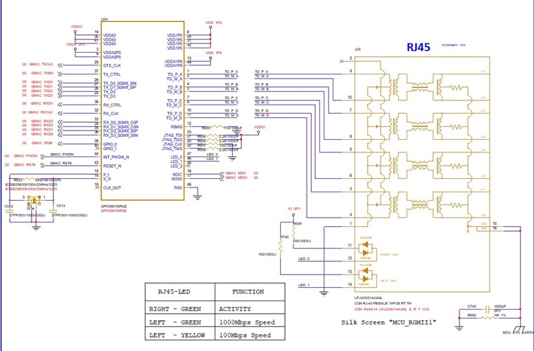

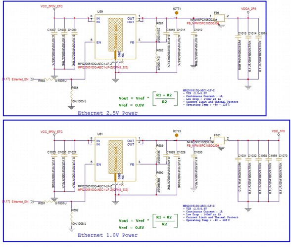

Hello TI experts,
my customer made their own PCB with DP83867IS, and they have some problems now.
first they had a trouble with test their own PCB, so they deleted "PHY_1000BT_FEATURES" in device driver, and connected their PCB to PC using LAN cable.
and they succeed with 100Mbps communication.
After those step, they restored "PHY_1000BT_FEATURES" again in device driver.
they succeeded with eth0 up, and going to LINK status. but PC side presents 100Mbps link, and DP83867IS side presents 1000Mbps link.
and it seems that these 2 module communicate with 100Mbps.
is there any check points that can solve this problem? (register setting or device driver, or other things)
I attach 2 register dump files. It is dumped after "ifconfig eth0 [ip addr] up" command, before connecting cable. after connecting cable, it does not work as 1Gbps.
(basic read = dp.log.basic.txt / extend read = dp.log.ext.txt)

    Here is one more request, could you review the schematic of DP83867?
    we want to know if there are any points to concern about this issue.
    Chase

  • Hi Chase,
    Here are my comments regarding the schematic:
    1. Power supply decoupling is inadequate. Please ensure the power pins have the capacitors according to section 10 of the datasheet, and that the caps are placed as close to the pins of the PHY as possible. I cannot see the VDDIO or VDDA1P8 LDOs in the images you sent.
    2. Does MDIO have a 2.2k pullup resistor?
    3. JTAG pins (20-23) should be left floating if unused.
    4. The magnetics used are not compliant with the requirements listed in section 9.2.1.1 of the datasheet. See note (1) "Each center tap on the side connected to the PHY, must be isolated from one another and connected to ground via a decoupling capacitor (0.1 µF recommended)."
    I believe fixing the above issues will solve your problem.
    David
