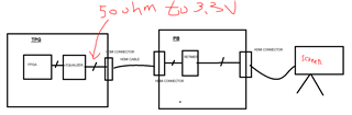

We have board lets call it TPG(Test Pattern Generator board) that include FPGA that transmit constant pattern(it doesn't need HPD/I2C/CEC etc.) and routed to equalizer and from equalizer(from another company) to HDMI connector - this is the source side.

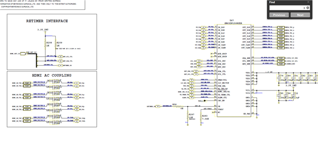

Here is the part of the schematic from the TPG side:
In my board that Im using lets call it PB this is the sink side, the signals comes from HDMI connector (the TPG is connected to my board trough HDMI cable) and routing to TI RETIMER :SN65DP159RGZR
Here is part of the schematic(with not include the HDMI connector ):
simplified block diagram :
The problem:
in the PB - at the output of the Retimer there is a connection to the screen with another HDMI connector,
and the screen does not RECIEVE the video that the TPG transmits,
but if for example I take the cable that is connected to the TPG and connects to the screen directly(see some video) then back to my PB card,
suddenly the signals are received properly and I see them on the screen.
I would expect that if there was a problem of detection then it will continue to be,
it is important for me to note that there is no HPD and it is not even connected at all on the side of the TPG. It seems that the equalizer does not recognize the retimer.

    Can you please show the full connection of the DP159?
    I notice the OE pin has a 10k pulldown, can you remove R58 and replace R297 with a 0.22uF capacitor? This will create a passive reset circuit that will satisfy the DP159 power up sequence requirement.
    but if for example I take the cable that is connected to the TPG and connects to the screen directly(see some video) then back to my PB card, suddenly the signals are received properly and I see them on the screen.
    Are you saying that if you connected the TPG directly to the screen, then you are able to see the video? In this case, does the equalizer output support AC coupling cap that is required by the DP159? If not, do you have 50ohm to 3.3V termination between the equalizer output and the AC coupling capacitor as shown below,

    1. OE is controlled by internal FPGA in the PB, so in start condition it pull-down to 0 that turn it off (I tried connect the cable after all the voltages in PB rise up , and try it before they rise up , no change, tried a lot of combination) , you still recommend to try your advice?
    Are you saying that if you connected the TPG directly to the screen, then you are able to see the video?  - Exactly. and then unplug the cable and connect to PB and magic happen and it works.
    2. At the first picture you can see I have only AC-Coupled capacitor , no termination to 3.3V, but I expect when I connect the cable from TPG to PB the termination in DP159 will be felt by the equalizer (DP159 contain 50ohm internal termination connected to VBIAS )

    The HDMI is a 3.3V DC-coupled interface, I am suspecting the equalizer output is expecting to see this 3.3V common mode voltage because when the TPG is connected directly to the screen, the equalizer sees the 50ohm termination to 3.3V in the screen and then enables its output.
    But with the AC-coupling between the equalizer output and the DP159, the AC coupling capacitors blocks the DP159 common mode voltage. This is why I propose to add the external 50ohm to 3.3V termination to properly biased the equalizer output. The DP159 Vbias is also 0.7V, not 3.3V.
    You can probe the equalizer output directly with and without the 50ohm to 3.3V to see if adding the external 50ohm termination will enable the equalizer output.

    *** You would need to provide 50ohm to 3.3V termination on all three TMDS data lanes plus the clock lane. But you can start with the clock lane and see if you can see the clock coming out of the equalizer with and without the external 50ohm to 3.3V.
