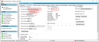

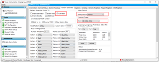

I'm trying to find if the connection is ok from UB941 TO LCD,How to make the UB928 display the color bar image output by UB941 which configured with internal clock and timing in Pattern mode ?

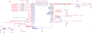

TDA4VM DSI ---> UB941  --->  UB928 -- > LCD
