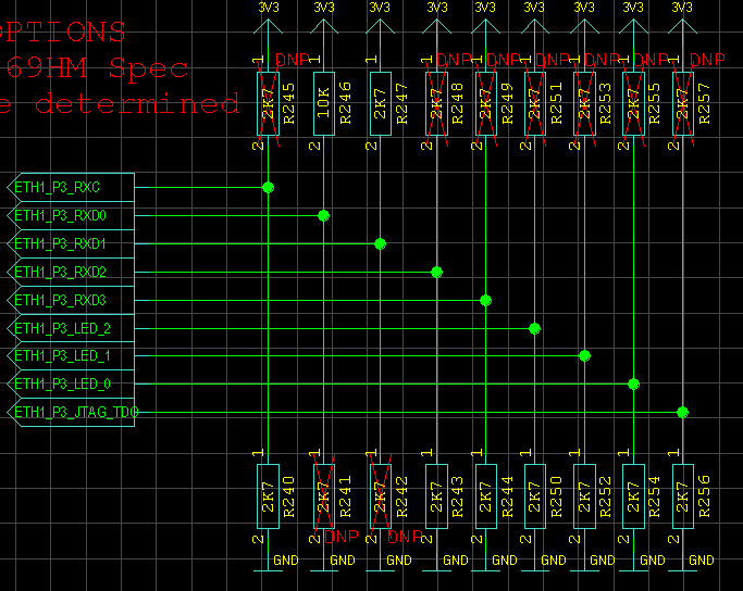

i'm failing to read the SMI registers of the DP83869HM device on our design. For most registers I get the value 0x8AD1 (including PHYIDR1/2), some return 0. I have no idea why i get this register value.
MDC/MDIO signaling looks ok. Accessing other PHYs on the same lines works. I'm using the same PHY address that has been selected by strapping (0x0F).
In the datasheet I found this hint at the description of pin INT_N/PWDN_N: "When register access is disabled through pin option, the interrupt will be asserted for 500 ms before self-clearing". However, i found no other hints on how the register access could be disabled. Might this be the problem in our design?
