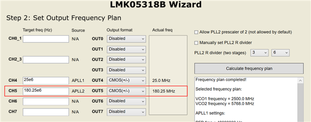

Ds90ub941 displays normally when using DSI clock, but displays jitter when using external clock.
The register is configured 0x56 = 0x01

What is the DSI PCLK rate and what is the frequency of the REFCLK?

XO =24.000 MHz, CH4 = 25 MHz, CH5 = 180.25 MHz.tcs
this is lmk05318b configurations
I tried this to eliminate jitter
Are you saying that overriding the sync widths fixed the jitter or no?
Can you try running PATGEN with internal timing and external clock to see what result this has on the screen?
If that works correctly, then please try PATGEN with external timing and external clock. Basically follow this flow chart to see where it breaks:

1. Overriding the sync widths couldn't fixed the jitter.
2. try PATGEN with internal timing and external clock,video is ok
3. try PATGEN with external timing and external clock,video is jitter
4. read DSI_VC_DTYPE Register = 0x3E,does it right?
5. I'm not sure what kind of DSI mode we are currently using,I will check with who in charge with it.
6. This is the screen parameter
My best guess here based on the data provided is that the sync widths are not getting regenerated in the DSI stream with correct timing. It may require some deeper analysis of the DSI stream with an analyzer to see what is happening. See section 4.3 of this app note for detail https://www.ti.com/lit/pdf/snla356
