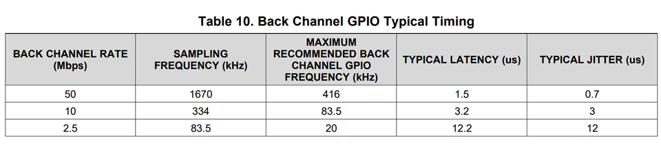

  • Hello David,
    I suggest to take a look at the supported back channel GPIO rates from the datasheets based on which device you are looking at. For example, in the 954 datasheet there is this table:
    All devices have information like this in the datasheet documentation. Please reach out if you are having trouble finding it.

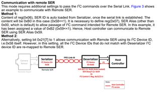

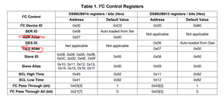

    3. For this table, why need to use SER alias and DES alias,  because there are already SER ID and DES ID, if use SER Alias and DES Alias, they are repeated, could you help use a example to illustrate?
    4. For Method 1,  if the SER side have only one camera with one sensor and one SER, still need to configure the SER Alias to communicate with SER?
    It doesn't work if use the SER ID 0x58?
    Also for the I2C command , use 7-bit address 0x59 or 8-bit address 0xB2?

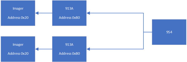

    The aliasing allows communication with multiple remote slave devices which have the same physical I2C address. For example let's say you have a dual deserializer hub like DS90UB954-Q1 connected to two identical imager modules which use the same addresses for the serializer and the imager. In order to communicate with each slave device independently you need to create an alias map so that transactions intended for each individual component can be addressed independently and re-mapped through the FPD-Link chain.
    For example you could set
    FPD RX Port 0 Slave ID0 = 0xB0
    FPD RX Port 1 Slave ID0 = 0xB0
    FPD RX Port 0 Slave ID1 = 0x20
    FPD RX Port 1 Slave ID1 = 0x20
    FPD RX Port 0 Slave Alias0= 0xB2
    FPD RX Port 1 Slave Alias0= 0xB4
    FPD RX Port 0 Slave Alias1= 0x22
    FPD RX Port 1 Slave Alias1 = 0x24
    Now when the host attached to 954 tries to access address 0xB2, the transaction will be automatically remapped to target 0xB0 on port 0. When the host tries to access address 0xB4, the transaction will be automatically remapped to address 0xB0 on port 1 and so on.
    If there is only one SER in the system it is not necessary to create an alias or the alias can just match the physical address of the part since there are no conflicts. I2C command 8 bit format or 7 bit format depends on how the host processor processes I2C transactions. Some processors/programming languages use 8 bit addressing while others use 7 bit. They are functionally equivalent
