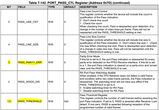

  • Hello Xinyu,
    When you power-up the system, does the processor or display show any flickering or loss of video data. I noticed that the LOCK_STS_CHG bit in register 0x4D is also set, so can you test to see if LOCK is stable, by reading register 0x4D multiple times, with a small delay between each read?
    If the LOCK_STS bit is always set to 1 and the LOCK_STS_CHG bit remains constant at 0 after multiple reads, then the LOCK is stable.
    In regards to the PASS status on the 960, the designer can set the conditions on which PASS is lost in register 0x7D. Your configuration script shows that register 0x7D = 0x01. This means that the PASS_PARITY_ERR bit is set to 0 and the PASS_THRESHOLD bit is set to 1.
    When PASS_PARITY_ERR is set to 0, the port PASS indication is deasserted for every parity error detected at the receiver port.
