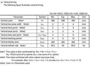

My customer use 941 to drive two displays, attached are the datasheet of displays. The input is like below, could you kindly help generate the sample code? Thanks!

    1. The picture that you have provided from the datasheet displays that the customer is attempting to superframe the two inputs into one input in order to use one input port. Is this correct?
    2. After reading over the datasheet, we noticed that this may not be possible. Please verify that the blanking times on the datasheet are correct.
    ^ Above is the vertical timing of their smaller screen. The vertical blanking time is only 10 for this screen. We need a minimum vertical blanking of 240 to match the larger screen.

    1. Splitter mode means that the two input images must have the same resolution. In this case, the second image is superframed with additional padding to have the same resolution as the first image.
    2. Cropping an input video on the 941AS is achieved by taking the input video and getting a smaller active output resolution by putting the rest of the resolution into blanking. This does not eliminate the need of blanking.
    3. As shown from above, Horizontal front and back porch may be eliminated with an offset. In order to achieve the bottom diagram where the horizontal blanking is reduced, you would need to use 2x independent REFCLKs to the 941AS so that the PCLK rate of the smaller video can be reduced and this will cause the 941AS to strip pixels from the horizontal blanking.
    4. Vertical front and back porch cannot be eliminated from the vertical blanking with an offset.
    Unfortunately, it seems that the 941 will not be able to handle their needs. We may recommend upgrading to a 98X unit to better format the output resolution.
