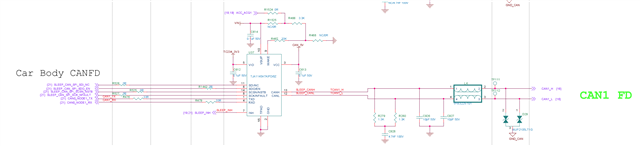

In our PCBA,the wake PIN of 1145 is float, not connected to other device.It's OK?
Does it support wake-up on a specific CAN frame ID,at the same time,Ignore CANFD frame wakeup?
Because TCAN1145 has an internal bias for the WAKE pin, it is fine to leave this pin floating if unused. If possible, connecting this pin to GND will increase noise immunity and stabilize the signal during initial power-up, but this is not required.
TCAN1145 can be configured for selective wake while ignoring CAN FD frames by setting SW_FD_PASSIVE = 1 in the SW_CONFIG_1 register (h44).
The schematic here looks good. No hardware changes are required when switching from this competitor device to TCAN1145. Software changes will need to be implemented to support the different SPI requirements and register maps of TCAN1145.
