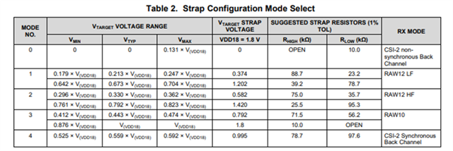

On the 954 can you help confirm what the default back channel frequency will default to for each of the strapped modes:

Mode #0 -- BC runns at a speed of 10Mbps, Frequency (½ fBCC = 5 MHz)
Mode #1, 2, 3 -- BC runns at a speed of 5Mbps, Frequency (½ fBCC = 2.5 MHz)
Mode #4 -- BC runns at a speed of 50Mbps, Frequency (½ fBCC = 25 MHz)
