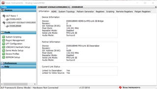

Dear Ti,
The pixel clock from my HDMI signal to the EVM adapter board is about 139hz, but after conversion to the FPD link signal, the pixel clock becomes about 131hz.
I don't know why? Can you analyze it for me?

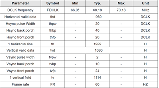

Is it because of my display parameters? It is consistent with standard 1920 × The display resolution of 1080 is slightly different.
So I want to confirm with you: do I need to brush EDID based on this parameter into EVM board again.
If necessary, can you help me provide the EDID of this parameter?
Thank you very much.
Xinyu.

  • Xinyu,
    This is expected behavior - the PCLK is not actually different. You are just seeing margin of error for the PCLK reporting accuracy on the two sides. 949 and 948 use different detection methods to measure the PCLK value and neither is expected to be highly accurate. In practice the 949 is typically much more accurate than the 948.
    Casey
