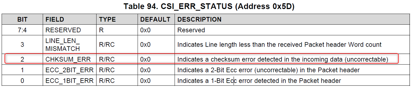

My customer encounters screen flicker phenomenon, and they use our 935&954.
In 935 side, they find that 0x5D bit 2=1. Could you please tell me what condition will result in CHKSUM_ERR?

    CHKSUM_ERROR is asserted when the 935 detects an error in the check sum portion of the incoming CSI-2 data, the check sum error status is then forwarded to the DES though the BCC, see section 7.3.1.6 of the 935 datasheet. So it is most likely the image sensor or its connection to the SER that is causing the check sum errors.
