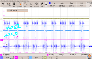

TLIN1441-Q1: when used in spi mode, i send 0,2,4,6,8,10,12,14,16 to read reg0-reg8, i got the result as follows.

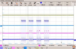

    In fact, figure 9-12 is exactly what makes me feel confused.  Accorddint to this figure, if I want to read h'0[7:0], I need to send address(0) + read (0). And I also need to send 8'0 to supply clock of response following.
    When I send 8'0 + 8'0, I'm supposed to get 0x54 at the last 8'0. And when i send 8'0 + 8'0 + 8'0 + 8'0, I'm supposed to get two 0x54.
    But here's what i have got(0x45,0x4c,0x49).
    Could you please help me to get the right result ?
    And does TLIN1441-Q1 support  continuous transmission?
  • Hi Ying,
    To end the first SPI transaction, nCS should go high again. You can bring nCS low again to issue the next read command.
    From what I can see in your image, it doesn't look like nCS is changing during this time. Could you give this a try?

  • Hi Danny,
    I tried to change nCS after every transation, and i got the right response.
    Your advice is really helpful ! Thank you very much!
