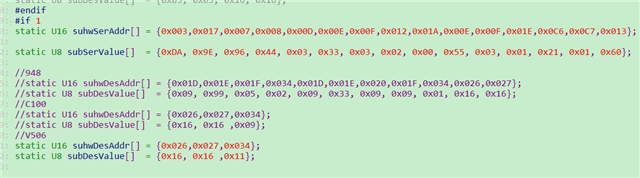

  • Here are the script for 947 and 948, could you help modify and make it works in secondary link only mode? Thanks.
  • Hi Dongbao,
    Thank you for your question. As long as you leave the 947 and 948 in auto-detect mode, via the registers you identified, this configuration will work without any other changes needed.

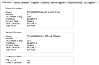

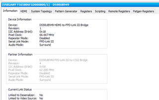

  • Hello Darrah,

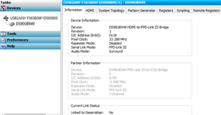

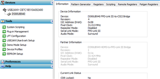

    We have experimented with 947 and 940 EVM boards:
    1. Only connecting to PORT0 (949: DOUT0+, DOUT0-; 940: RIN0+, RIN0- ), use the default configuration and you can communicate directly.
    Read Remote Registers successfully
    2.Only connecting to PORT1 (949: DOUT1+, DOUT-1; 940: RIN1+, RIN1- ), using the default configuration, the communication cannot be successful. As shown in the figure, the Remote Registers cannot be read.
    Change the value of  the register 0x34[] :value 0x01 to 0x1B, 940 can read Partner Information of 949, but the Partner Information is grey and the Remote Registers cannot be read.
    The corresponding 949 terminal cannot read the information of 940 at all.

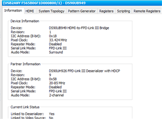

    Change the register 0x1E[] in 949: Value 0x01 to 0x02, and display the connection to the Deserializer, but the display is 926, and the Remote Registers still cannot be read.

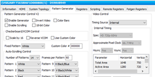

    3. Keep the configuration and connection method in 2, and Check Enable Generator, and change Timing Source to Internal.
    On the 940 side, you can see the 949 information, and it shows that the connection is Yes, and the Remote Registers of the 949 can be read.

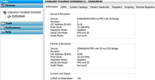

    But on the 949 side, you can see that the Partner Information can read the information of 940, but it is gray, and the Remote Registers cannot be read.

  • Hi Dechao and Xiaoxiang,
    Thank you for the detailed updates.
    The second I2C address (enabled by setting PORT1_I2C_EN) enables a I2C address specifically for Port1. For example, when only Port1_SEL is set register access for Port1 will be from the primary I2C address. When the second I2C address is enabled access to Port1 registers will be from the address DeviceID+1. This is essentially giving each port a specific address. For your application the primary address should be enough since you are only using Port1, but it may be worth testing if the remote registers could be read with the secondary address.
    The 948 does have a forced input mode via the DUAL_RX_CTL register, which could be an option other than the MCU.
    Just to confirm, have you enabled I2C pass-through or set any slave alias? When you attempt to read the remote registers are they all set to zero or are you unable to see anything? Could you also check the values of registers 0x5A and 0x06 on the serializer side? It is odd that there is no link to the deserializer.

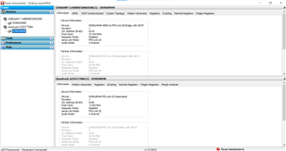

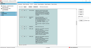

  • hi Darrah,
    Can you set up the bench test in the lab? It's easy to replicate the issue that customer and field are facing with.
    For ALP and EVM, the i2c pass through is enabled automatically when you try to read out all the remote registers; As you see from the screen shoot, 949 could detect the deser i2c address but not able to identify 940.
    The method you mentioned to set PORT1_I2C_EN, we also tried and change the i2c address from 0x58 to 0x5B (0x06 register address), it doesn't work.
    Based on current findings, i think the statement in datasheet is not accurate. Pls check with designer and retest in your lab.

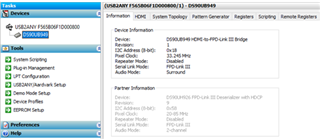

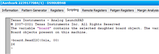

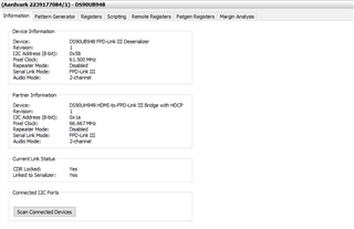

  • Hey Li,
    We have figured out the issue and created a working script. We are working with the 949 and the 948. Please follow these steps to replicate the solution on your side:
    1. Only connect to PORT1 (949: DOUT1+, DOUT-1; 948: RIN1+, RIN1- )
    2. On the 948 side: Select register 0x34 -> 0001 1000 (0x18)
    3. On the 949 side: Set Pattern Generator to enable generator and toggle timing source to Internal
      1. The 948 should be able to recognize and talk to the 949 now
    4. On the 949 Side:
      1. Create a python file with the following code to change the following registers. You may need to change the registers/device address for the device that you are using.
        serAddr = 0x18
        desAddr = 0x58
        board.WriteI2C(serAddr,0x1E,0x04) # Enable secondary I2C address for port 1
        board.WriteI2C(serAddr+2,0x03,0xDA) # Enable I2C passthrough on port 1
        print hex(board.ReadI2C(desAddr,0x00,1)) # Read DES address
      2. Run the code on the 949. 949 should be able to talk to the 948 without any issues now and vice versa.
      3. The ALP software will not recognize the 948. But the forward channel is in operation now
    Please let me know if you are able to replicate the solution on your end.
