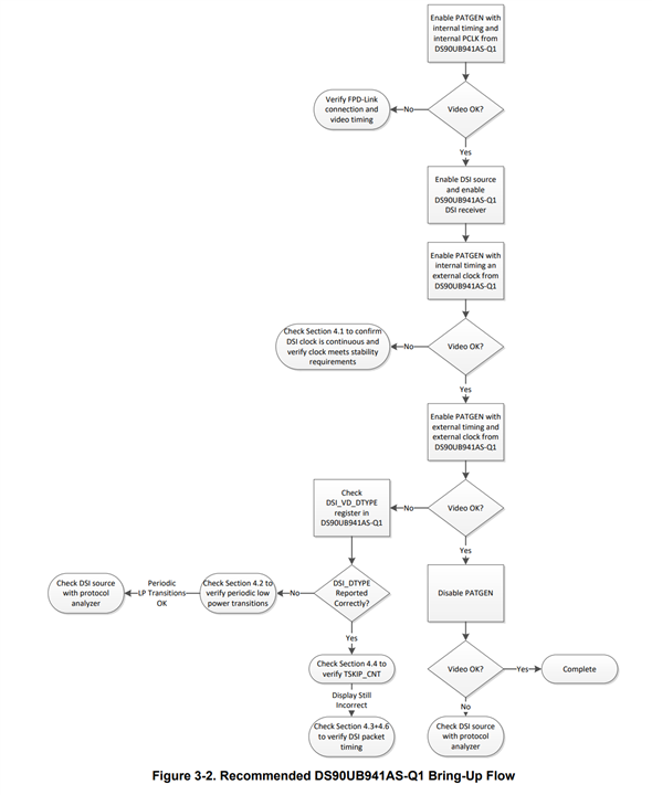

  • Hello Musthafa,
    For debugging 941AS bringup, I recommend to follow this guide book: https://www.ti.com/lit/pdf/snla356
    To be specific, please follow figure 3-2 which gives a step by step process to figure out where the problem is. Please let us know exactly where in the figure you are having an issue starting from the top and working down
    Here is a basic example script for 1920x720 for reference:

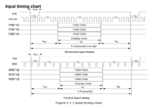

    Our TFT display is not using DE signal. it uses negative HS signal and negative VS signal.
    could you please let me know which are the registers needs to be set in serialiser and deserialiser along with vlaues.
    existing serialiser and deserialsier configurations are provided above in device tree.
    here i am attaching the input timing chart of TFT display
    could you please tell us the registers need to be configured in serilaiser and deserilaiser with respective values
    Thanks & Regards,
    Musthafa av
  • Hello Musthafa,
    I already provided an example script in my previous post. It is not clear to me from the above what operating mode your DSI source is in:
    - Non-burst mode with sync pulses
    - Non burst mode with sync events
    - Burst mode
    Can you clarify?
    Here is a new script with revised timing for the above you posted plus negative sync polarity:

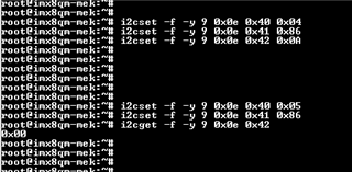

  • root@imx8qm-mek:~#
    root@imx8qm-mek:~#
    root@imx8qm-mek:~# i2cset -f -y 9 0x0e 0x40 0x10
    root@imx8qm-mek:~# i2cset -f -y 9 0x0e 0x41 0x86
    root@imx8qm-mek:~# i2cset -f -y 9 0x0e 0x42 0x0A
    root@imx8qm-mek:~#
    root@imx8qm-mek:~#
    root@imx8qm-mek:~#
    root@imx8qm-mek:~# i2cget -f -y 9 0x0e 0x42
    0x00
    root@imx8qm-mek:~#
    root@imx8qm-mek:~#
    there is no change in display by the above changes and its not reflecting also
    we are using DSI0 port only. DSI_CONFIG_1 and TSKIP registers are configured from device tree itself.
    kindly refer the device tree reg_config , please revert us back if we made any mistakes.
    thanks & Regards,
    Musthafa av

  • yeah basic i2c read write is working
    i can able to generate pattern also by using pattern generation control registers
  • Musthafa,
    It doesn't look like your device tree config matches what I gave before. This is what you have:
    0x01 0x08 0x1E 0x01 0x03 0x9A 0x1E 0x01 0x40 0x05 0x41 0x21 0x42 0x60 0x1E 0x01 0x5B 0x03 0x4F 0x8C 0x1E 0x01 0x40 0x04 0x41 0x05 0x42 0x0E 0x03 0x9A 0x01 0x08 0x17 0x9E 0x01 0x00
    The way I interpret this is register, write value, register, write value, repeated. If so, the instead it should be:
    0x01 0x08 0x40 0x040x41 0x05 0x42 0x14 0x41 0x21 0x42 0x60 0x40 0x10 0x41 0x86 0x42 0x0A 0x41 0x94 0x42 0x0A 0x01 0x00
    I also see what you are saying about the 0x86 and 0x94 indirect regs not reading back the written value but I have to dig deeper on this. I seem to recall they are write only but not read. Anyways I don't think that has anything to do with your issue here.
    When you got PATGEN working, which was that?
    - PATGEN with internal timing and internal clock?
    - PATGEN with internal timing and external clock?
    - PATGEN with external timing and external clock?
    I am trying to see where you are on this debug flow chart:
    Based on where you get stuck we can determine where exactly to look.
    Casey
    we are using UB941 and UB948 with Dual link FPD and single OLDI configuaration.
    LVDS channel is connected with our TFT dsiplay of resolution 1920x720
    and that is working on HV mode
    there is no DE signal.
    so how can we enable HV mode and disable DE mode in 941 serilaiser and 948 deserialser.

  • Musthafa,
    There is no such thing as DE mode vs. HS/VS mode in the 941AS. The 941AS always generates DE, HS, and VS signals and then if the panel uses DE only, then the HS/VS signals are simply ignored.
    Can you please respond to my previous question about your progress on the bringup flow chart? To help you debug this issue I need to know specifically which step in the flow chart you are getting stuck on starting from the top and working down the list
    Casey
