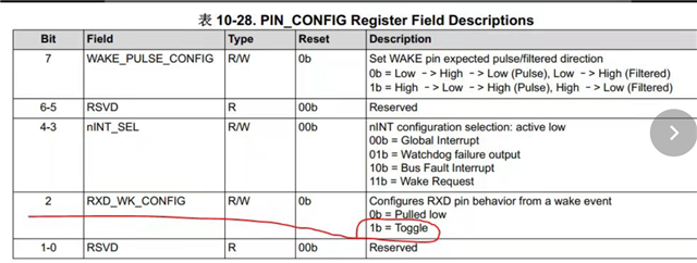

    My current configuration steps are as follows (standard frame):
    1. Configure the id of the message I want to wake up through the SW_ID register, and configure the corresponding SW_ID_MASK register to be all 0.
    2. Configure the RXD pin behavior from a wake event to toggle through the RXD_WK_CONFIG bit of the PIN_CONFIG register.
    3. The CAN baud rate is configured to correspond to the MCU baud rate through the SW_CONFIG_1 register.
    4. Configure the SWCFG bit to 1 through the SW_CONFIG_4 register to enable the wake-up configuration.
    5. Configure tcan1145 to sleep mode through MODE_CNTRL.

    It sounds like the RXD functionality is working in your application since the transceiver is able to wake the MCU. I'll try to help debug the current situation where the transceiver wakes for any CAN frame instead of only the correct WUF. If the RXD function does not seem to be working as expected, please let me know.
