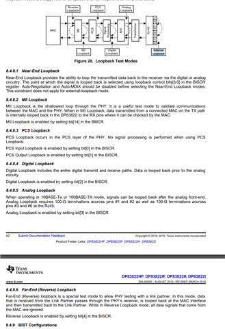

  • Hi Hillman,
    what do you mean by ethtool comment, I didn't get it? I am running this from userspace not uboot
    I tried running an external loopback test through ethtool, but it is giving this output : Operation not supported by endpoint
    I can read and write register through phytool now.
    In the datasheet 8.4.8 section, its not given how to perform an external  loopback test
    This is 8.4.8, I don't see any instruction or register given to perform the external test.
    Can you please provide a bit of explanation of how can I do an external test, which bits to enable?
    Asma
  • Hi Asma,
    External test need to short the wires physically. You need to short the pin1 to pin3 and pin2 to pin 6 in the RJ45. May I ask why did you want to use loopback test? you can also perform an digital, PCS, and Analog loopbacks. Those can be configure through Register 0x0016 in the datasheet.
    Hillman Lin
  • Hi Hillman,
    Thanks for the reply. This is for emission testing of our device.
    So I have shorted the pin in RJ45.  How can I send /receive packets and validate them?
    Do I have to write my own application for it, or does DP83822 do it internally and provide its status?
    Asma
  • Hi Asma,
    There are two ways you can check the send / receive packets
    • First, you can send the packet and receive packet from the MAC side.
    • Second, you can enable BIST configuration which is shown in session 8.4.9 in the datasheet through register 0016 and read the value in register 001B to check the error count.
