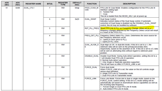

  • Hi Yao,
    Register 0x5B bit 5 is set to 1 by default. This will reset FPD-Link III PLL on frequency Change detected and will result in a reset of the FPD3 PLL.
    So setting it 0x5B[5] to zero will prevent the PLL from resetting. Please be careful with the PCLK frequency though.  If it changes too much, it will cause problems. For now let me know if this fixes your issue.
    Fadi A.

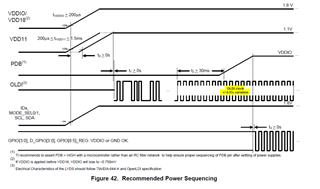

  • Hi Yao,
    Unfortunately, with such gross LVDS clock +/- 3 MHz fluctuation, the 947 output data will get corrupted which will causing the 948 lock signal to lose lock due to data corruption caused by the LVDS CLK fluctuation on the 947 side.
    The main issue is not in the 948 lock side or the 947 PLL side. The issue is that your CLK fluctuation is out of spec for what the 947 recommends in the datasheet - see datasheet image below.
    Refer to 9.1 Power-Up Requirements and PDB Pin in the 947 datasheet for more details.
    OLDI clock variation should be  +/-0.5% per device spec.
    Fadi A.
