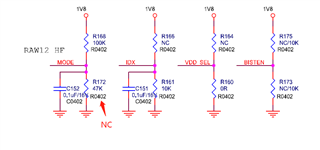

We use DS90UB933 to match DS90UB954 for camera data transfer. We have confirmed that the camera side can output normal video stream for display (using DS90UB934 EVM), but when the camera is connected to the DS90UB954 side (ECU), there is no MIPI signal output. Here is the specific information:

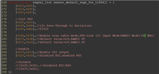

Camera side (933): The format of the video signal output from the ISP is 1280*720@30fps@YUV422 8bit, and the serializer has been set to 10bit mode.

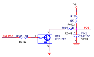

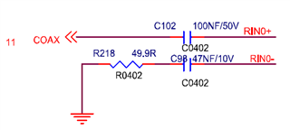

ECU side (954): The 954 has been set to RAW 10-bit mode, when the camera module is connected, the lock and pass signal is HIGH, the 954 can access the 933 through I2C, but there is no MIPI signal output.
The software configuration information and hareware SCH of the 954 are as follows:
Please help to assess whether there is a problem, thank you!!
