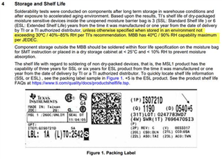

Hi Team,
What temperature does SN75LBC179 need to be stored at? It's not specified in the datasheet. Do they have to stick to <30C like described in this general document or can they store it at -20C to +60C, like most other devices?
https://www.ti.com/lit/an/snoa550h/snoa550h.pdf
Thank you,
Franz
  • Hi Franz,
    I have reached out to our internal team to see if we have a known storage temperature range (some of these older parts in this family do not have one listed). I will update you when I have the information - could be before the EOD today or potentially early next week on Monday - but I wanted to let you know we are looking into it.
    Parker Dodson
  • Hi Franz,
    So I was able to get the answer - they ran the temperature cycling tests at -65C to 150C for the storage temp - so that should be what to expect (it is also in line with similar devices)
    Please let me know if you have any more questions!
    Parker Dodson
