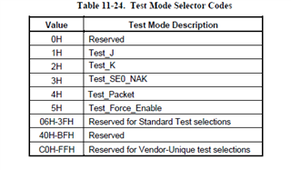

Hi Jeff,
There does not exist a linux tool to complete this kind task in Linux nor is one provided by TI. Please reference this thread for extra detials:
Hi Malik,
But any register config can set let TUSB8020B enter to test mode?
Thanks!
Jeff
Jeff

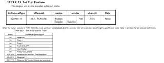

You have to use the USB Set_Feature command to enable test packet generation.
USB2 compliance test section,
When the feature selector is PORT_TEST, the most significant byte (bits 15..8) of the wIndex field is the selector identifying the specific test mode. Table 11-24 lists the test selector definitions.

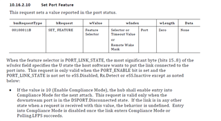

USB3 compliance test section,
David
Hi David,
But I can't find register parameter in the document.
Would you please share the command?
Thanks!
Jeff
Jeff
Please refer to the USB2.0 and USB3.2 spec from the USB.org document library, https://usb.org/documents?search=&category%5B%5D=49&tid_2%5B%5D=40&items_per_page=50.
David
