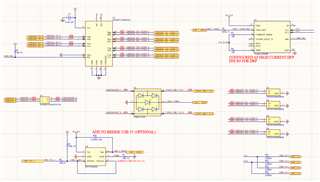

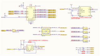

I have a USB-C issue I need to resolve around MUX switching using a TUSB321RWBR and HD3SS3212RKSTQ1 on my custom board.
My issue is this... When the CC lines are connected straight through from chip to chip (i.e. CC1 to CC1 and CC2 to CC2), I get no USB 3 enumeration upon plugging a USB-C hub into my board (host) in both directions. When I swap the CC lines from chip to chip  (i.e. CC1 to CC2 and CC2 to CC1) I can get it to enumerate but only upon plugging in one direction. The test hub is compliant and works both directions when plugged into a Windows machine. Here is a snippet of the schematic.
Thank You
