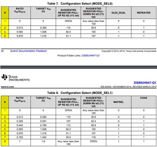

  • Hey Roy,
    Bits 7 and 3 are status bits that indicate the mode select values have been latched and is stable. Bits [6:4] and [2:0] decode what values the MODE_SEL1 and MODE_SEL0 have been latched too respectively. The mode the decode bits refer to are indicated by the highlighted columns of Table 7 (MODE_SEL0) and Table 8 (MODE_SEL1) that I included below. These modes are determined using resistor voltage dividers to pins of the device and are put into different modes through hardware. The registers referred to in your screenshot is the software status used to confirm the modes.
    You can refer to section 7.4 in the datasheet for more information on their configurations. I have included Table 6 which includes the settings that need to be strapped for what modes.
    Based on the table above you are correct that if you are working in dual pixel mode OLDI_DUAL = '1'. Please reach back out if you have any other questions!

    Thanks for information. I used EVM board and I found my mode_sel had two status, one is 0x8C and the other is 0x8A. May you let me know if possible to have two content if we didn't change the mode_sel resistors?
    For 8C=10001100, I don't find # state in the mode_sel0
    For 8A =10001010, it's #2 about mode_sel0, is it correct?

  • Hey Roy,
    When you say it had two statuses, were they measured at different times? Is there anything in your software that is overriding the mode selects?
    While the datasheet modes are indexed started at 1 in the table, the register modes are actually decoded starting from index 0. Can you confirm at what points you measured the 2 different statuses? If the values weren't stable your initial reading may not have been accurate.
    The ALP should show a PCLK value of 50MHz.

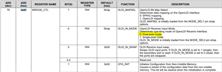

    We bought 7pcs EVM board and we selected mode_sel0 = #5. The 0x4F[6] should indicate the dual pixel mode, but when we read 0x4F[6], we found there was still showing single pixel mode. Can you help use your side EVM to check if issue can be duplicated?

  • Hey Roy,
    Can you confirm which value you are reading from 0x4F[6]? For OLDI mode you should see 0, not 1 like the strap mode for mode_sel0 = #5 would suggest. I have included the register table and the note that confirms this.

  • Hi Corinne,
    As I said, there is conflict between mode_sel setting and 0x4F[6] bit. 0x4F[6] =  '1' when I set mode_sel0 = #5 .
    I need to use ALP to modify the 0x4F[6] by myself and let panel normal operated. Can you use your side EVM to check whether can duplicate the issue?

  • Hey Roy,
    We tested this in the lab for you and were able to replicate the issue. We think it may be a startup sequence issue for the EVM specifically, can you try hold and releasing the PDB after you have strapped the values and powered on the device to see if that fixes the issue?

  • Hi Roy,
    We find that the reset will not switch correctly, and PDB is needed. However, if they need solution to swap, they can use the below action.
    But customer are check if there is method can fix the issue without using manually action.
    The method would be directly updating the register to target mode.
    Can we take a step back though, what is issue with using register override when using EVM? Is customer seeing this on their actual hardware?
