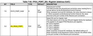

    Once the 935 and 960 are successfully LOCKed onto each other, you can check the LINE_COUNT and LINE_LEN registers in the 960 to detect the video data being received by the 960.
    First, select one RX Port to read from in register 0x4C.
    Next, read registers 0x73-0x74 in the 960 to get the 16-bit value for the number of video lines that the 960 received in the latest video frame that was sent.
    Then, read registers 0x75-0x76 in the 960 to get the 16-bit value for the number of bytes that the 960 has detected in each video line it received. Multiply that number by 8 (bits per byte) and then divide by the number of (Bits-Per-Pixel) for the data type of the video sent, in order to calculate the detected number of pixels that were received in each video line received by the 960 at the selected RX Port.

    First, can you double-check and make sure that the RX_READ_PORT register is configured for the specific RX Port that you are monitoring?
    For example, if your serializer is connected to RX Port 0 on the 960, then register 0x4C[5:4] should be equal to 00.
    After that, can you read register 0x4D multiple times and make sure you have a stable LOCK on the selected RX Port?
    The LOCK_STS bit should be a constant 1 and the LOCK_STS_CHG bit should be 0 after multiple reads, to indicate stable LOCK.
    If you have selected an RX Port to read from and have a stable LOCK at the selected RX Port, then the counter registers will be able to detect if video data is being received by the 960 at the selected RX Port. If you are reading 0x00 in all of the registers, then video is not being sent to the deserializer.
