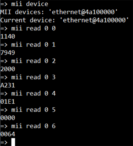

But, I could not see any messages printed out when I just put the ethernet cable into rj45 in u-boot, which is got from TI-SDK.
I just got message like:
I guess that accessing through MDIO interface is working well as I see the message shown in the picture.

  • Hi GukHyun,
    What is the intended speed of operation?
    Can you please let me know why Mirror mode is enabled and aneg is disabled on your custom board?
    Can you please share a block diagram/image of your connections?

    How did you know the the mirror mode state or aneg state?
    From register picture I showed?
    I don't know the intended speed.. I just connected it in RGMII.
    Do you mean that I should configure something in registers or strap for speed of operation?
    Really thanks!!
  • Hi GukHyun,
    I was able to see that the mirror mode is enabled from the schematic.
    I couldn't completely understand how and where you have connected DP83867 and how you are reading the registers. A block diagram or a detailed explanation of connections will help.
    Gokul.

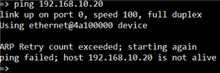

    For a next step, when I connect ethernet cable from PC to the board, I checked establishing the auto-negotiation and linking up.
    After configuring the ipaddr and netmask, I tried to send ping to a PC, but it failed like:
    The view of wireshark is:
    The 0f:a3:be:e8:6c:d0 is am335x's mac address, I guess.
    I know that before sending PING packet, there should be a APR exchange for building MAC table.
    But the packet is not a ARP and it is not even clear protocol.
    Could you give me a help?

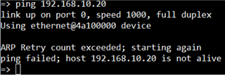

  • Hi Gokul,
    I had a little progress.
    In 100Mbps, I can check in wireshark that the board sends ARP packet and the PC replied for it.
    (I guess it may be an impedance matching issue. I will check it later..)
    But, I think the board cannot receive the ARP packet sent from PC.
     So, I wonder if there are some problems in my DTS file and board.c file.
    Please check it...
